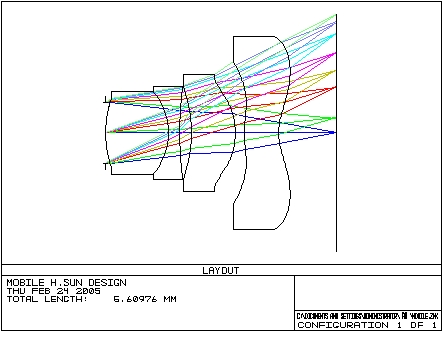

 楼主| 发表于 2005-2-24 16:48:00 | 显示全部楼层
<P>Layout</P>
<img src="data/attachment/forum/dvbbs/2005-2/200522581128769.jpg" border="0" onload="if(this.width>screen.width*0.7) {this.resized=true; this.width=screen.width*0.7; this.alt=\'Click here to open new window\nCTRL+Mouse wheel to zoom in/out\';}" onmouseover="if(this.width>screen.width*0.7) {this.resized=true; this.width=screen.width*0.7; this.style.cursor=\'hand\'; this.alt=\'Click here to open new window\nCTRL+Mouse wheel to zoom in/out\';}" onclick="if(!this.resized) {return true;} else {window.open(\'data/attachment/forum/dvbbs/2005-2/200522581128769.jpg\');}" onmousewheel="return imgzoom(this);" alt="" />
[此贴子已经被作者于2005-2-25 8:11:41编辑过]

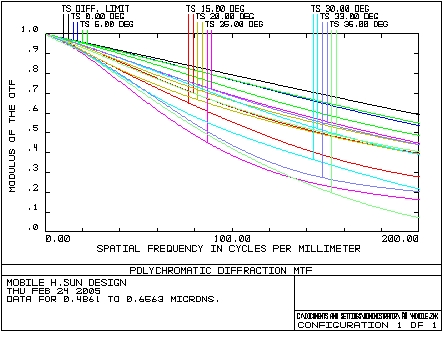

 楼主| 发表于 2005-2-24 16:53:00 | 显示全部楼层
<P>MTF</P>
[此贴子已经被作者于2005-2-24 17:07:12编辑过]
 楼主| 发表于 2005-2-24 16:54:00 | 显示全部楼层
<P>MTF</P><img src="data/attachment/forum/dvbbs/2005-2/200522581227782.jpg" border="0" onload="if(this.width>screen.width*0.7) {this.resized=true; this.width=screen.width*0.7; this.alt=\'Click here to open new window\nCTRL+Mouse wheel to zoom in/out\';}" onmouseover="if(this.width>screen.width*0.7) {this.resized=true; this.width=screen.width*0.7; this.style.cursor=\'hand\'; this.alt=\'Click here to open new window\nCTRL+Mouse wheel to zoom in/out\';}" onclick="if(!this.resized) {return true;} else {window.open(\'data/attachment/forum/dvbbs/2005-2/200522581227782.jpg\');}" onmousewheel="return imgzoom(this);" alt="" />
[此贴子已经被作者于2005-2-25 8:12:31编辑过]

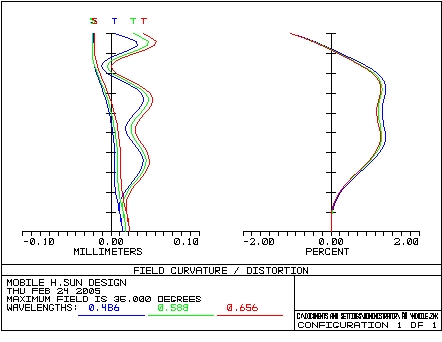

 楼主| 发表于 2005-2-24 16:55:00 | 显示全部楼层
<img src="data/attachment/forum/dvbbs/2005-2/200522581313886.jpg" border="0" onload="if(this.width>screen.width*0.7) {this.resized=true; this.width=screen.width*0.7; this.alt=\'Click here to open new window\nCTRL+Mouse wheel to zoom in/out\';}" onmouseover="if(this.width>screen.width*0.7) {this.resized=true; this.width=screen.width*0.7; this.style.cursor=\'hand\'; this.alt=\'Click here to open new window\nCTRL+Mouse wheel to zoom in/out\';}" onclick="if(!this.resized) {return true;} else {window.open(\'data/attachment/forum/dvbbs/2005-2/200522581313886.jpg\');}" onmousewheel="return imgzoom(this);" alt="" />
[此贴子已经被作者于2005-2-25 8:13:15编辑过]
