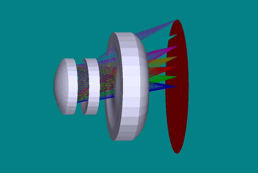

<P>三维图</P>
<P>焦距5.6,视场62°</P><img src="data/attachment/forum/dvbbs/2004-9/2004911214628838.jpg" border="0" onload="if(this.width>screen.width*0.7) {this.resized=true; this.width=screen.width*0.7; this.alt=\'Click here to open new window\nCTRL+Mouse wheel to zoom in/out\';}" onmouseover="if(this.width>screen.width*0.7) {this.resized=true; this.width=screen.width*0.7; this.style.cursor=\'hand\'; this.alt=\'Click here to open new window\nCTRL+Mouse wheel to zoom in/out\';}" onclick="if(!this.resized) {return true;} else {window.open(\'data/attachment/forum/dvbbs/2004-9/2004911214628838.jpg\');}" onmousewheel="return imgzoom(this);" alt="" />

不知道F#是多少

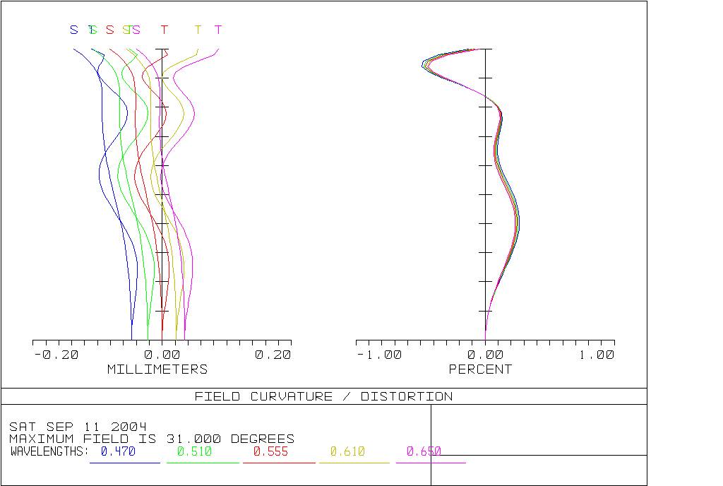

<img src="data/attachment/forum/dvbbs/2004-9/2004911215143993.jpg" border="0" onload="if(this.width>screen.width*0.7) {this.resized=true; this.width=screen.width*0.7; this.alt=\'Click here to open new window\nCTRL+Mouse wheel to zoom in/out\';}" onmouseover="if(this.width>screen.width*0.7) {this.resized=true; this.width=screen.width*0.7; this.style.cursor=\'hand\'; this.alt=\'Click here to open new window\nCTRL+Mouse wheel to zoom in/out\';}" onclick="if(!this.resized) {return true;} else {window.open(\'data/attachment/forum/dvbbs/2004-9/2004911215143993.jpg\');}" onmousewheel="return imgzoom(this);" alt="" />
畸变图
zhouxiaojun 楼主Lv.10 发表于 2004-9-12 05:52:00|浙江 | 查看全部
<img src="data/attachment/forum/dvbbs/2004-9/2004911215230459.jpg" border="0" onload="if(this.width>screen.width*0.7) {this.resized=true; this.width=screen.width*0.7; this.alt=\'Click here to open new window\nCTRL+Mouse wheel to zoom in/out\';}" onmouseover="if(this.width>screen.width*0.7) {this.resized=true; this.width=screen.width*0.7; this.style.cursor=\'hand\'; this.alt=\'Click here to open new window\nCTRL+Mouse wheel to zoom in/out\';}" onclick="if(!this.resized) {return true;} else {window.open(\'data/attachment/forum/dvbbs/2004-9/2004911215230459.jpg\');}" onmousewheel="return imgzoom(this);" alt="" />
像差图

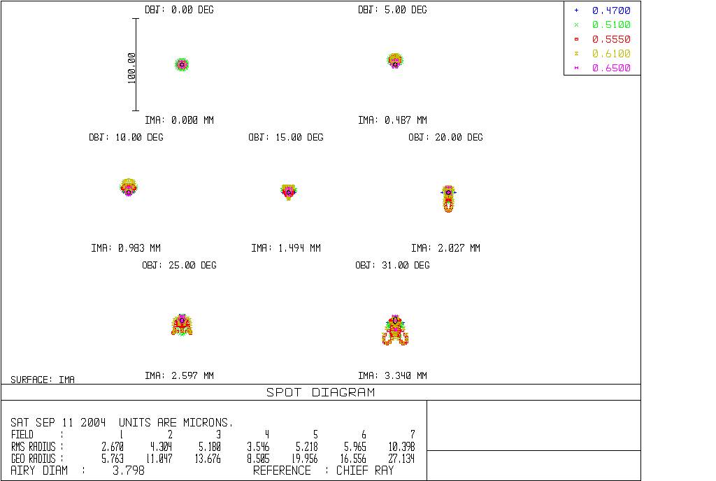

<img src="data/attachment/forum/dvbbs/2004-9/2004911215317922.jpg" border="0" onload="if(this.width>screen.width*0.7) {this.resized=true; this.width=screen.width*0.7; this.alt=\'Click here to open new window\nCTRL+Mouse wheel to zoom in/out\';}" onmouseover="if(this.width>screen.width*0.7) {this.resized=true; this.width=screen.width*0.7; this.style.cursor=\'hand\'; this.alt=\'Click here to open new window\nCTRL+Mouse wheel to zoom in/out\';}" onclick="if(!this.resized) {return true;} else {window.open(\'data/attachment/forum/dvbbs/2004-9/2004911215317922.jpg\');}" onmousewheel="return imgzoom(this);" alt="" />
点列图

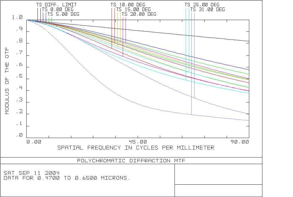

<img src="data/attachment/forum/dvbbs/2004-9/200491121543380.jpg" border="0" onload="if(this.width>screen.width*0.7) {this.resized=true; this.width=screen.width*0.7; this.alt=\'Click here to open new window\nCTRL+Mouse wheel to zoom in/out\';}" onmouseover="if(this.width>screen.width*0.7) {this.resized=true; this.width=screen.width*0.7; this.style.cursor=\'hand\'; this.alt=\'Click here to open new window\nCTRL+Mouse wheel to zoom in/out\';}" onclick="if(!this.resized) {return true;} else {window.open(\'data/attachment/forum/dvbbs/2004-9/200491121543380.jpg\');}" onmousewheel="return imgzoom(this);" alt="" />
传函图

请问总长多少? 还有sensor的边缘入射角是多少?

chief ray angle?
wushenjian Lv.10 发表于 2004-9-13 16:22:00|浙江 | 查看全部
几个非球面,装配工艺性好吗?
