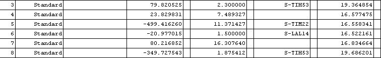

<P>請問Tolerancing如何作?謝謝!</P>
<P>以下是我遇到的問題:</P>
<P><IMG src="http://us.f2.yahoofs.com/users/41609022zca02d4b7/a74c/__sr_/22e3.jpg?phaq2aBBi9Pp77Gs" border=0></P><IMG src="http://us.f2.yahoofs.com/users/41609022zca02d4b7/a74c/__sr_/32b9.jpg?phaq2aBBbpIf1Zf9" border=0><img src="data/attachment/forum/dvbbs/2004-10/20041012131637384.jpg" border="0" onload="if(this.width>screen.width*0.7) {this.resized=true; this.width=screen.width*0.7; this.alt=\'Click here to open new window\nCTRL+Mouse wheel to zoom in/out\';}" onmouseover="if(this.width>screen.width*0.7) {this.resized=true; this.width=screen.width*0.7; this.style.cursor=\'hand\'; this.alt=\'Click here to open new window\nCTRL+Mouse wheel to zoom in/out\';}" onclick="if(!this.resized) {return true;} else {window.open(\'data/attachment/forum/dvbbs/2004-10/20041012131637384.jpg\');}" onmousewheel="return imgzoom(this);" alt="" />
<img src="data/attachment/forum/dvbbs/2004-10/20041012131653581.jpg" border="0" onload="if(this.width>screen.width*0.7) {this.resized=true; this.width=screen.width*0.7; this.alt=\'Click here to open new window\nCTRL+Mouse wheel to zoom in/out\';}" onmouseover="if(this.width>screen.width*0.7) {this.resized=true; this.width=screen.width*0.7; this.style.cursor=\'hand\'; this.alt=\'Click here to open new window\nCTRL+Mouse wheel to zoom in/out\';}" onclick="if(!this.resized) {return true;} else {window.open(\'data/attachment/forum/dvbbs/2004-10/20041012131653581.jpg\');}" onmousewheel="return imgzoom(this);" alt="" />

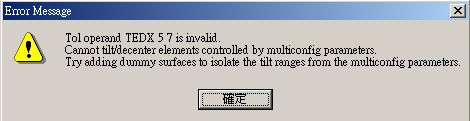

<P>出現Error Message後就不能作分析了</P>

在 zemax中,多重结构中的数据是不能直接进行公差 分析的。可以加一个dummy面隔离,或 把多重结构分开。
