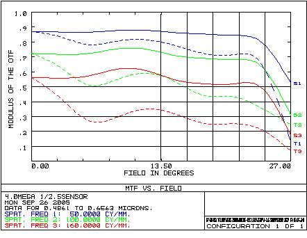

How output MTF&Field diagram in CODE V?
2.3k
7
johncai
2005-9-26 18:25:00
共 7 个
redflag
Lv.14
2005-9-26 21:18:00
in cv_macrmtfvsflds 50 100 160

johncai
2005-9-27 00:19:00
I see, I see, thank you for your help!
