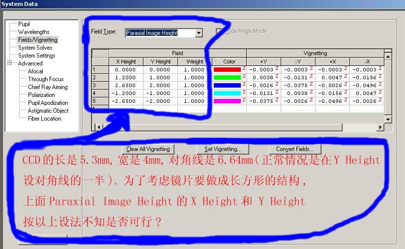

<img src="data/attachment/forum/dvbbs/2004-10/20041013151559321.jpg" border="0" onload="if(this.width>screen.width*0.7) {this.resized=true; this.width=screen.width*0.7; this.alt=\'Click here to open new window\nCTRL+Mouse wheel to zoom in/out\';}" onmouseover="if(this.width>screen.width*0.7) {this.resized=true; this.width=screen.width*0.7; this.style.cursor=\'hand\'; this.alt=\'Click here to open new window\nCTRL+Mouse wheel to zoom in/out\';}" onclick="if(!this.resized) {return true;} else {window.open(\'data/attachment/forum/dvbbs/2004-10/20041013151559321.jpg\');}" onmousewheel="return imgzoom(this);" alt="" />
请教像高
请教像高

为什么要将镜片弄成方的?

2004-10-15 16:23:00
因为要减小镜头的体积.

2004-10-15 19:04:00
当然是可以的.这样的计算结果可能会跟只设成Y方向的MTF有一点差异,但是不大.主要是因为MTF的方向改变了.

2004-10-15 22:02:00
<P>谢谢版主的回复!</P><P>按照上面X ,Y 的设法和只设Y方向两种方法,他们的最大像高是一样的吗?</P><P>我上面的设法最大成像面能到6.64吗?</P>
