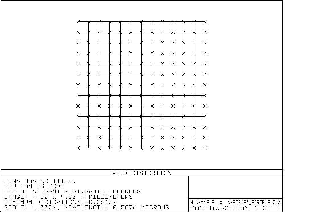

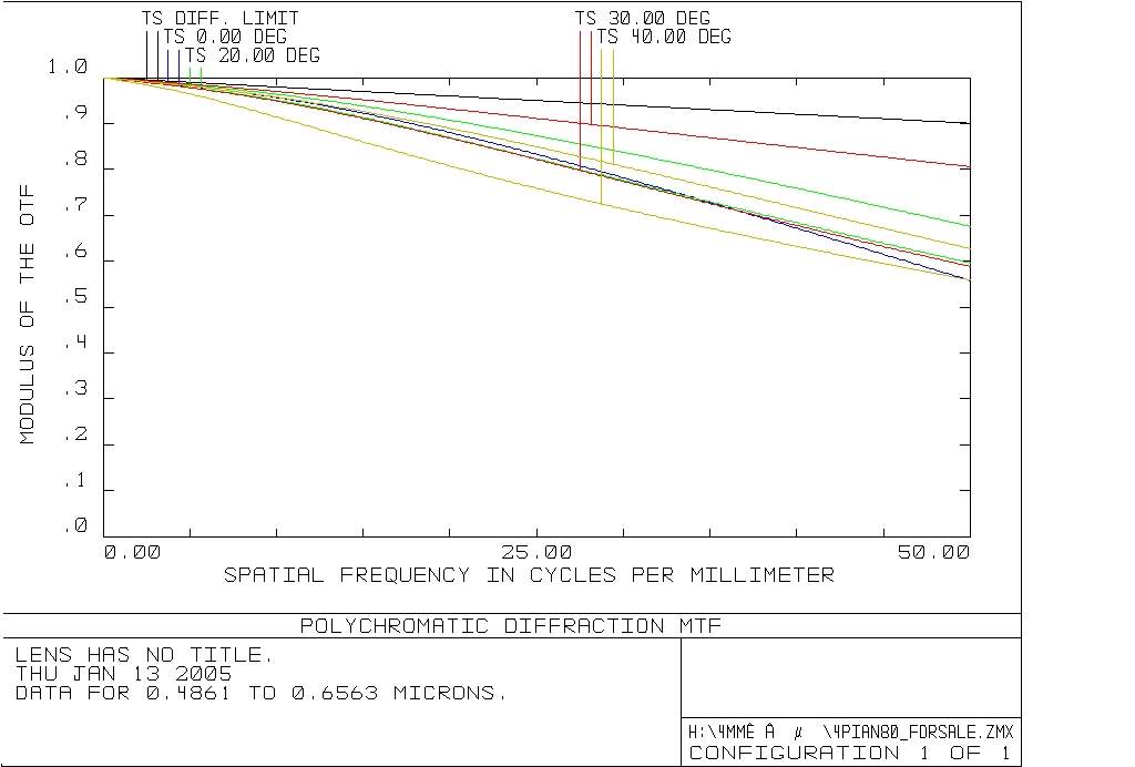

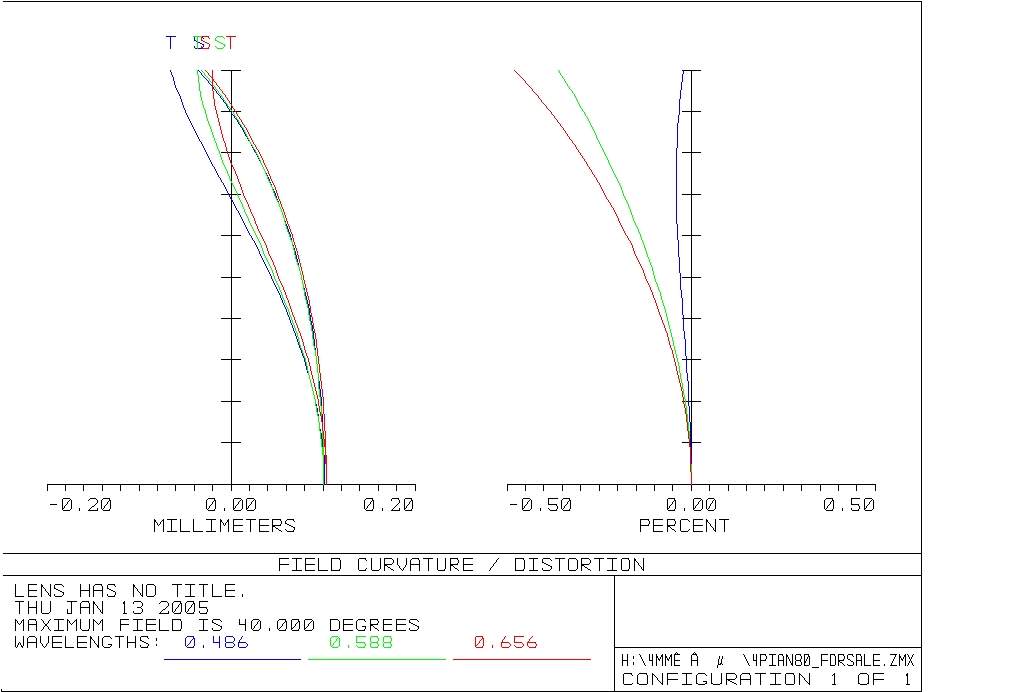

<P>前面有个相关的设计,不过畸变控制的一般,我设计的也是4mm,F数2.8,FOV也是80度,畸变控制的还行(有图为证),MTF就没那么好了,50lp/mm0.5,一般用用也可以了,呵呵。</P>
<P>如果需要,请加我qq:45711978,注明OECR</P><img src="data/attachment/forum/dvbbs/2005-1/20051131613938.jpg" border="0" onload="if(this.width>screen.width*0.7) {this.resized=true; this.width=screen.width*0.7; this.alt=\'Click here to open new window\nCTRL+Mouse wheel to zoom in/out\';}" onmouseover="if(this.width>screen.width*0.7) {this.resized=true; this.width=screen.width*0.7; this.style.cursor=\'hand\'; this.alt=\'Click here to open new window\nCTRL+Mouse wheel to zoom in/out\';}" onclick="if(!this.resized) {return true;} else {window.open(\'data/attachment/forum/dvbbs/2005-1/20051131613938.jpg\');}" onmousewheel="return imgzoom(this);" alt="" />

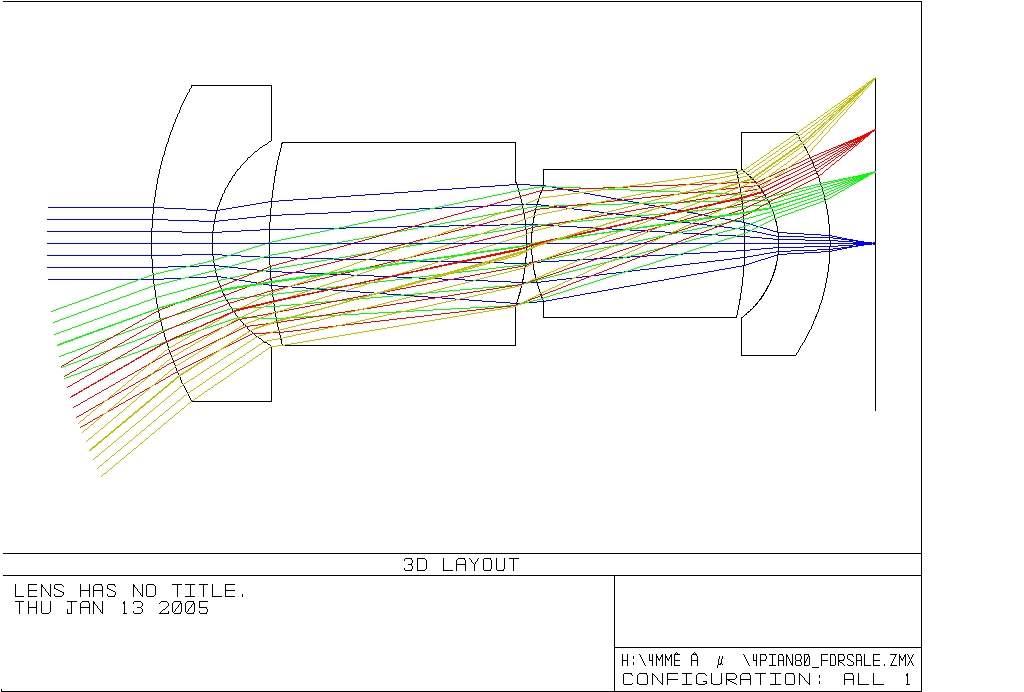

<P>也是4片,无非球面,TOTR=15</P>

做的很好,MTF也满高的了

<P>结构如何?</P>
发表于 2005-1-19 19:10:00 | 显示全部楼层
所用材料呢,有没有不好加工的?

畸变,MTF都很不对!佩服楼住哦,向你学习。
发表于 2005-11-3 18:30:00 | 显示全部楼层
50lp/mm0.5太差啦!佩服你的勇气
