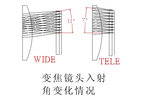

<P>我设计一个数码相机变焦镜头,是用在CMOS上的,</P>
<P>主光线入射角TELE时为11度.WIDE时反过来为7度.</P>
<P>请教各位高手这样变化的主光线入射角可以吗?</P><img src="data/attachment/forum/dvbbs/2004-7/200472611261734.jpg" border="0" onload="if(this.width>screen.width*0.7) {this.resized=true; this.width=screen.width*0.7; this.alt=\'Click here to open new window\nCTRL+Mouse wheel to zoom in/out\';}" onmouseover="if(this.width>screen.width*0.7) {this.resized=true; this.width=screen.width*0.7; this.style.cursor=\'hand\'; this.alt=\'Click here to open new window\nCTRL+Mouse wheel to zoom in/out\';}" onclick="if(!this.resized) {return true;} else {window.open(\'data/attachment/forum/dvbbs/2004-7/200472611261734.jpg\');}" onmousewheel="return imgzoom(this);" alt="" />

11度差不多可以接受,但是如果想提高边缘亮度的话,最起码要搞到8度以内比较合适.
