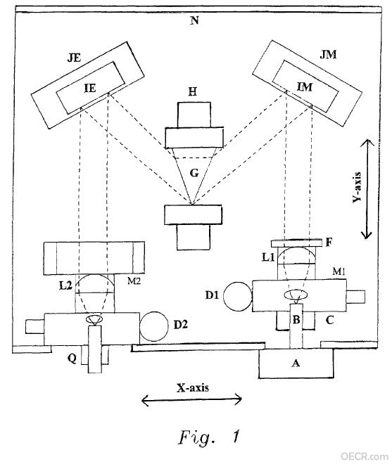

不久前听一个美国人讲到一种optical wedge,想要技术合作,他说可以将太阳能电池的效率提高好多,还可以用于光谱计用于医学诊断方面等等,很有前景,他提到一个专利,专利号是7286582
http://patft.uspto.gov/netacgi/nph-Parser?Sect1=PTO2&Sect2=HITOFF&p=1&u=%2Fnetahtml%2FPTO%2Fsearch-bool.html&r=1&f=G&l=50&co1=AND&d=PTXT&s1=7286582.PN.&OS=PN/7286582&RS=PN/7286582
摘要如下:
This invention consists of an optical external cavity having specialized Brewster angle wedges. The external cavity apparatus utilizes several types of very high index of refraction wedges made from semiconductor and special glass materials. The apparatus limits the oscillation of the optical wavelength modes emitted by a diode laser. In addition, such cavities also simplify the motions of the moveable mirror that returns these selected laser photons to the cavity input beam path or fiber. The wedge also disperses the laser light to isolate the desired wavelength band better than the currently used grating systems. Wavelengths other than the desired wavelength band are dispersed, then reflected at angle away from the return fiber and thus not returned to the amplification cavity inside the laser. The apparatus then emits only the laser photon mode desired by the user.
专利的附图
专利的附图
有没有人了解这个呢?做激光器的高手们有人用过这种器件吗?
还是不太懂它的原理和应用,如果把这样的器件和方法用在光谱计里,有怎样的好处呢?
